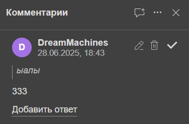

  1. It would be nice imo, if the search (Ctrl+F) function would work for comments as well.
    I used to past into the comments links for the literature I’m referring to in the course work and then. When it’s time to edit and finalize the table breaks, check if the text is not hanging on the half-filled pages and stuff, I quickly went through the comments by text search (Ctrl+F) to find the links and left a reference-number. Tho here I had to find space to put a link to the source in text, then leave in here and in a couple of times, deleting links changed text lay-out on the pages, so I had to re-make table breaks decorations.

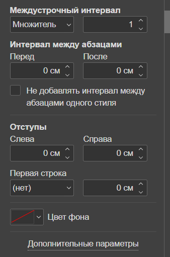

  3. That would be nice to be able to navigate thorough the paragraph parameters menu.
    I know that now the vertical arrows are here to change parameters’ value and horizontal - to move the cursor for the right spot. For my situation, I don’t really make use of them, since in the requirements for my Uni basically all the indents and paragraph intervals are 0 except the left indent that should be 1.25 cm. So if I create any list I have to click through the parameters to re-value them back to 0. In order to optimize that process, I want either of 3 things: to make arrows lead the navigation between parameters cells, and when you change between them - every time size number is highlighted, so you’d be able to reassign the value without the need to replace the courser to change some part of the value. You can also consider make navigation with
keys, since they do not impact the value of a parameter anyway. Also, you can consider the option to change default parameters of the list - whether as in the selected list (as with the text headings), or to assign and remember default values of the lists (indent parameters and interline internals) in order not to change them according with the same requirements over and over again.

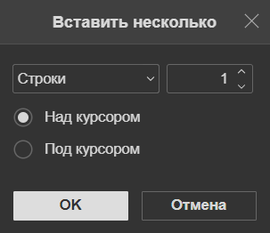

  2. And finally, I think that would also be nice, if in the menu of adding multiple rows or columns to the table
    the menu would save last selected parameters. Multiple times I’ve added the same number of rows under the cursor, I did not know how many I would need and kept adding them with an increment of 10 or so. And I had to click on it again and again to change default parameters to the one I needed. Maybe add in the same space under the options of “below” of “under” the cursor, the switch to remember last selected option, so utilizing this option would be generally more flexible without forcing a user to adapt to the new “track last selected choice” thing.
