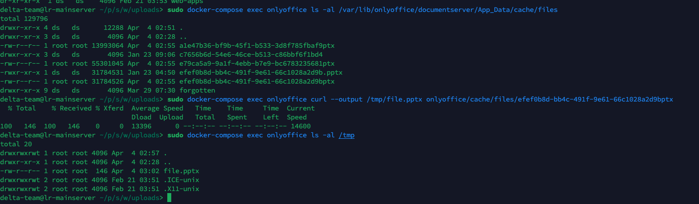

I have a problem. I use local storage to original files to optimize open document timing. It’s work successful. And I need to convert PPTX files to PDF as intermediate form before sliding as PDF files per page. Files will be available at GET http://web/files/open?id=1&token=. i check access with use
sudo docker exec onlyoffice curl -o /tmp/file.pptx "http://web/files/open?id=1&token=<token>"
command and it is dowloaded success.

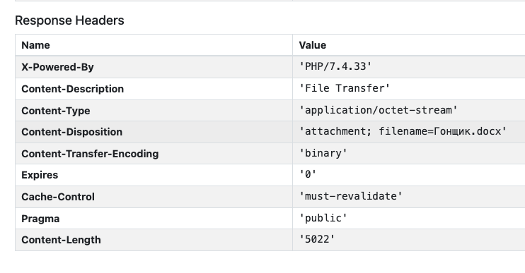

Local storage module return file as octet-stream with this headers:
File opens in editor, but ConvertService.ashx can’t be read a file.

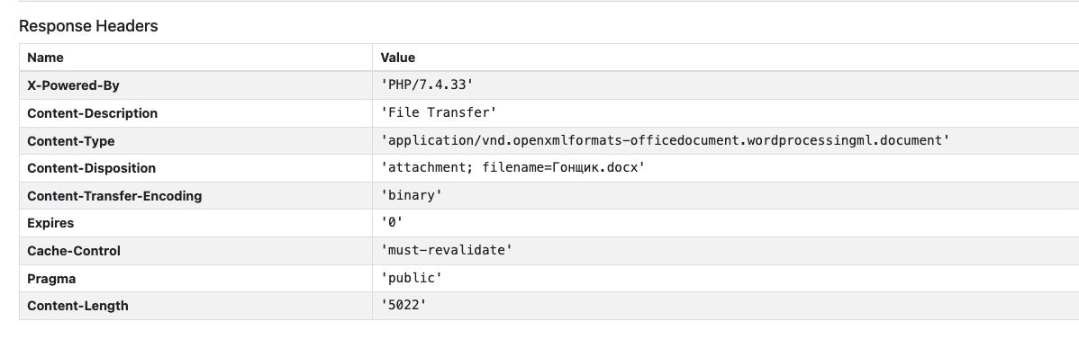

I try set a MIME type of file in request:
but it not work.

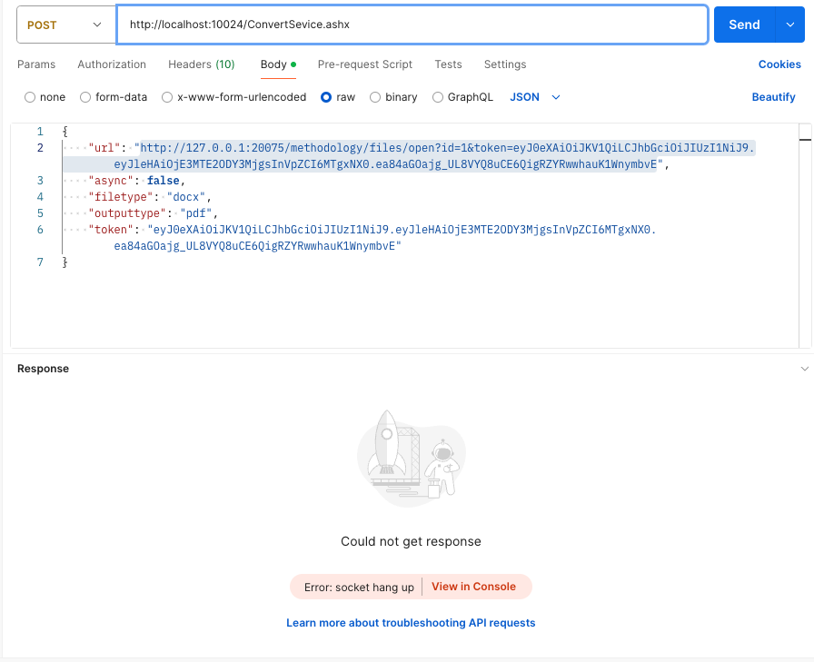

I can’t connect to the service, but ping for it is OK:

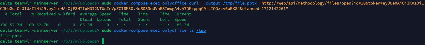

I try use volume and self-directing URL’s to loading files as local. it’s not works too. And I check what this URL’s is correct too:
