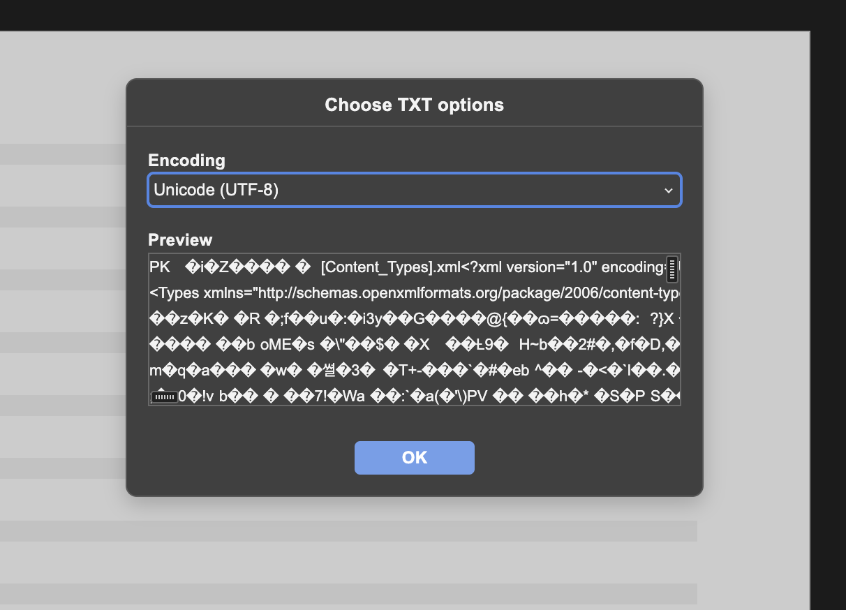

When editing any file (docx, xlsx, pptx) in the Document Server, the file gets corrupted after saving. Showing this image.

The document gets corrupted after saving, and the following error is displayed
