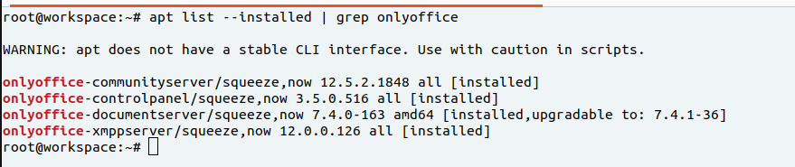

Please execute apt list --installed | grep onlyoffice command and share the output.

  1. the command output
  2. the record video

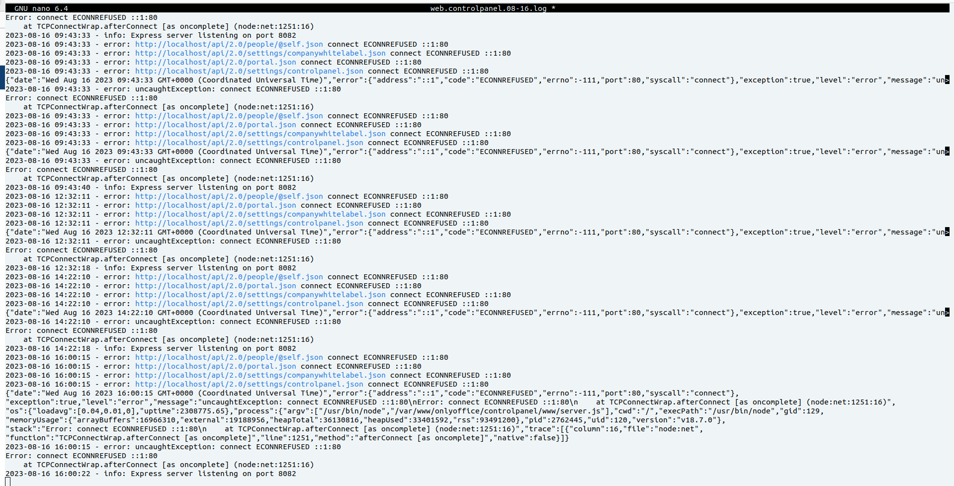

Can you please provide logs of Community Server and Control Panel for analysis? Logs are located in /var/log/onlyoffice/CommunityServer and /var/log/onlyoffice/ControlPanel respectively.
Additionally, please check if editing of documents works, i.e. just open any document and try to edit it. Let me know the result.
  1. editing document works
  2. result of /var/log/onlyoffice/web.controlpanel.08-16.log , i don’t see /var/log/onlyoffice/ControlPaneland /var/log/onlyoffice/CommunityServer
Please provide all logs from /var/log/onlyoffice/ in the archive. You can upload them to any cloud storage and share an external link.
ok thanks
Onlyoffice log

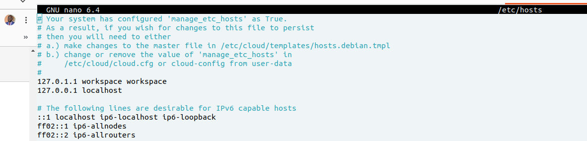

It seems that Control Panel cannot access Community Server. Please specify some additional information to get better understanding:
  • whether you changed default port (80) when installed Workspace;
  • if any proxy is used in your environment;
  • if there is localhost in /etc/hosts exists.

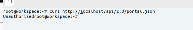

Please execute this command from the terminal of the server where Workspace is installed:
curl http://localhost/api/2.0/portal.json
Also, after that add /api/2.0/portal.json part to the address of your portal and check what it returns in the browser. After that please share both outputs.
result of curl :

Since there is one component is not updated, please run a test and update your portal to all actual versions. To update existing ONLYOFFICE Workspace components using DEB packages use command:
bash install-Debian.sh -u true -it WORKSPACE
I’d recommend preparing whole server backup before running through updating process.

In logs was an error indicating to the usage of IPv6 address for Control Panel:
error: http://localhost/api/2.0/portal.json connect ECONNREFUSED ::1:80
To make it run proreplly we changed localhost to 127.0.0.1 in production.json config of Control Panel located in /var/www/onlyoffice/controlpanel/www/config to avoid usage of IPv6 localhost which is ::1:80 like that:
