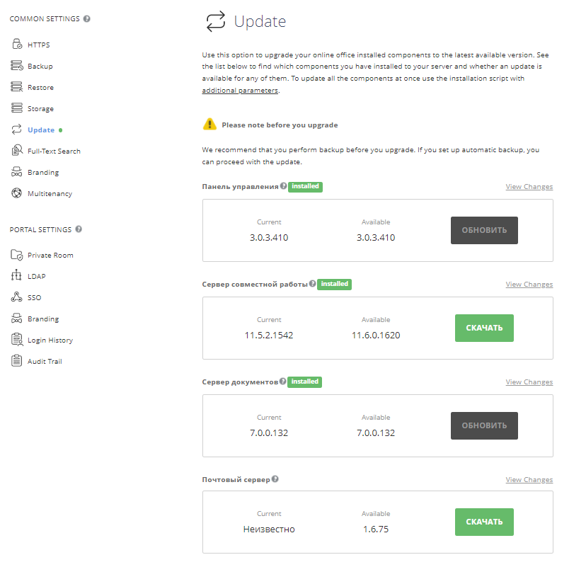

After updating Community Server using Control Panel I lost access to Control Panel with error 402. What steps can I take to diagnose the problem?
Community Server/Control Panel version: 11.5.2.1542/3.0.3.410
Type of installation of Workspace (docker, deb/rpm, exe) docker
OS: CentOS Linux release 8.4.2105
Browser version: Chrome
Please specify the way you installed the update for the Workspace.
Note that current versions of the Community Server and Control Panel are 11.6.0.1620 and 3.0.3.410.
Please run the installation script with an additional parameter -u true:
bash workspace-install.sh -u true
After that check if the issue persists.
I installing update by web interface.
After I download and update the Community Server, I will lose access to the Control Panel with error 402.

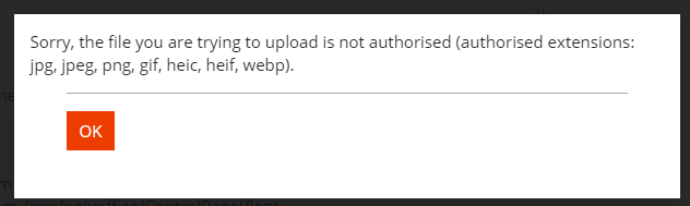

I would ask you to attach the requested log files, and not copy their content here.
I can’t attach the zip file.
