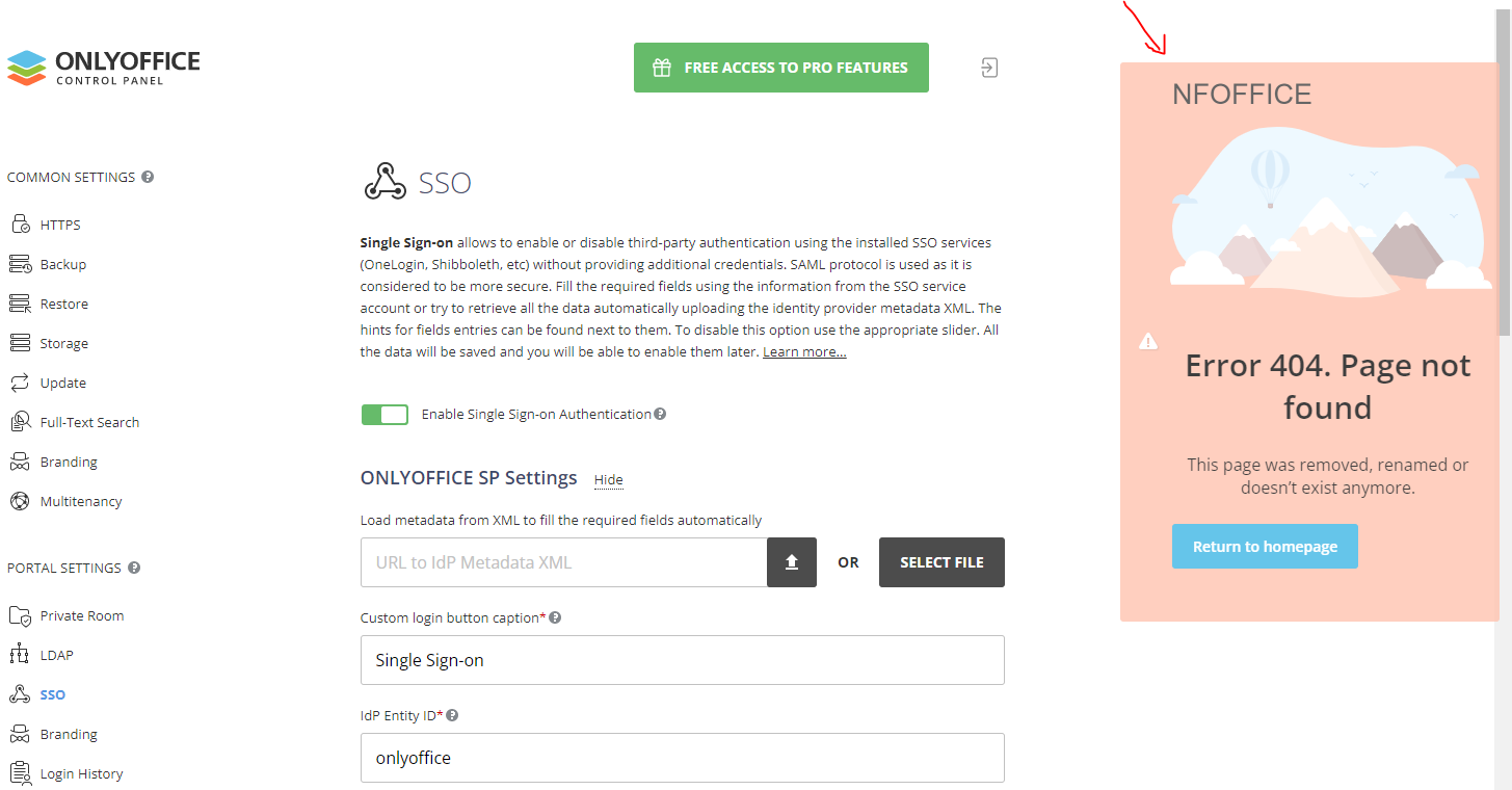

Control panel can't save SSO settings. 404 happens
Hi.
I’m try connecting onlyoffice to keycloak SSO.
Entering the configuration.
http_s://officesrv/controlpanel/sso/uploadmetadata - working
http_s://officesrv/controlpanel/sso/validatecerts - working
But when I click to “SAVE” button on SSO configuration page, I get the 404 error.
Browser console show error “http_s://officesrv/controlpanel/sso/settings” URL not found.
What could be the reason? Is there a way to manually enter configuration parameters?
Version: {“count”:1,“status”:0,“statusCode”:200,“response”:{“communityServer”:“11.6.1035”,“documentServer”:“7.0.0.132”,“xmppServer”:“11.0.63”}}
Control panel version: 3.0.389
Thanks for your help!

Yes, I’ve seen the instructions. If the system supports SAML, then there should be no problems.
I can’t understand why the settings can’t be saved. Usually there are problems with the configuration after saving the settings.
I found in “web.sso.*.log”
{“message”:“getPortalSsoConfigUrl: http_s://officesrv/ssologin.ashx?config=saml”,“level”:“debug”}
{“message”:“::1 - - [05/Apr/2022:07:18:23 +0000] "POST /uploadmetadata HTTP/1.1" 200 5945 "http_s://officesrv/controlpanel/sso" "Mozilla/5.0 (Windows NT 10.0; Win64; x64) AppleWebKit/537.36 (KHTML, like Gecko) Chrome/100.0.4896.75 Safari/537.36"”,“level”:“info”}
{“message”:“::1 - - [05/Apr/2022:07:18:23 +0000] "POST /validatecerts HTTP/1.1" 200 1128 "http_s://officesrv/controlpanel/sso" "Mozilla/5.0 (Windows NT 10.0; Win64; x64) AppleWebKit/537.36 (KHTML, like Gecko) Chrome/100.0.4896.75 Safari/537.36"”,“level”:“info”}
{“message”:“invalid route /settings”,“level”:“error”}
{“message”:“getPortal404Url: http_s://officesrv/404.aspx”,“level”:“debug”}
“invalid route /settings” is very strange.
Could you please reproduce the issue and provide us with whole Control Panel and Community server logs folders?
Also please reproduce the issue with open browser console (F12 in Google Chrome). Please check if there’re any error entries in ‘Console’ and ‘Network’ tabs. Please make screenshots.

I sent you changed web.config file via PM. Please try to use it. After that you have to restart ONLYOFFICE Server in IIS and ONLYOFFICE Control Panel in Windows Services.
NB! Please prepare whole server backup before any server side actions just in case.
Great, the settings are now saved. I had to rename the duplicate rule “ControlPanelRewrite”, otherwise the server would not start.
I returned the “SsoAuthRewrite” rule back, everything works too.
Thanks for the help.
Sorry, my bad. I had to remove the original rule after copy\paste action. Probably it slipped from my mind.
As the result of the issue (for other users). You need to move ControlPanelRewrite rule before SsoAuth + you need to remove SsoAuthRewrite rule.
We are already working on the fix which will be placed in next Community server version.
