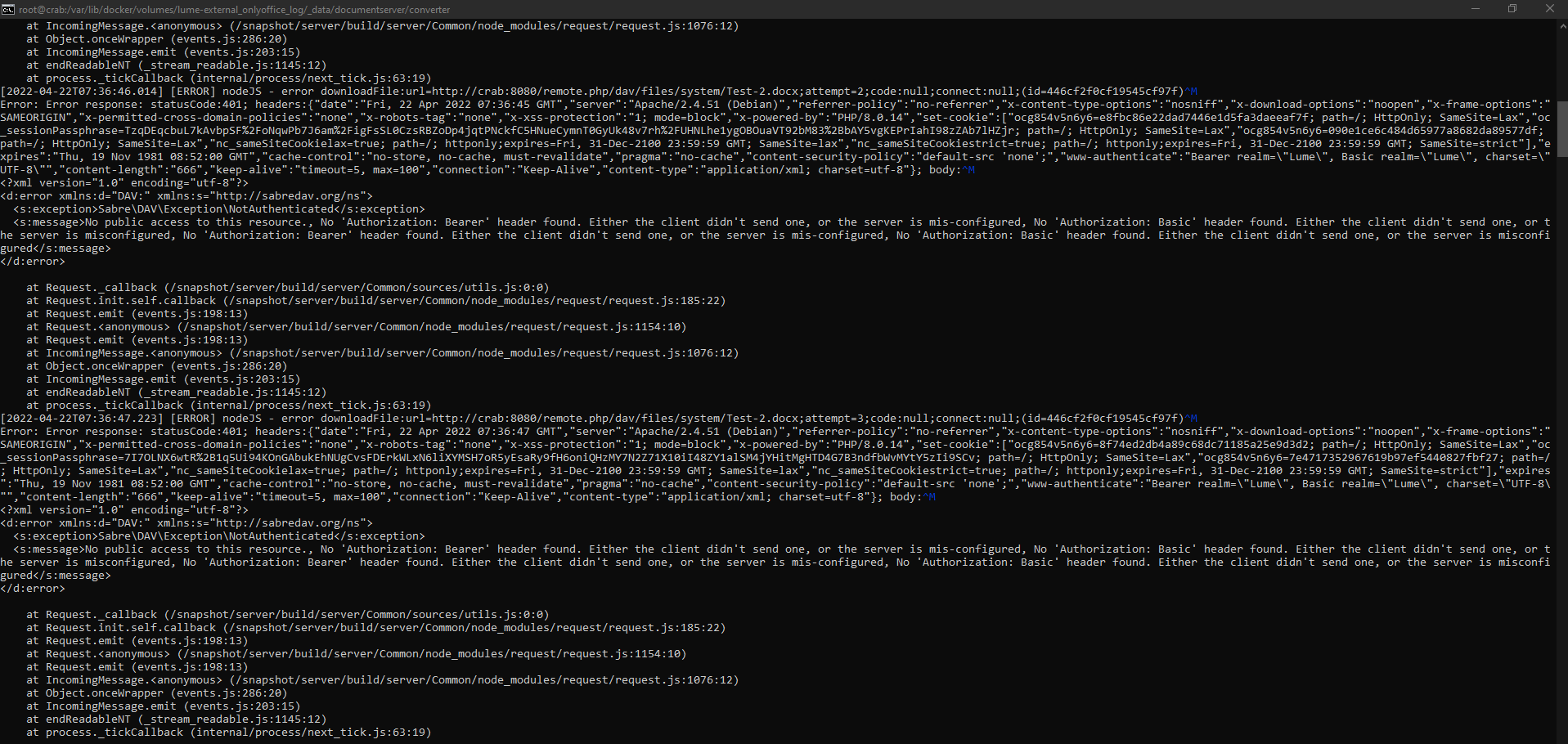

Please make sure the file is downloadable at the given link. Send me the log file /var/log/onlyoffice/documentserver/converter/out.log after reproducing the issue.
this is the log after trying to open the file, im using webdav to generate a link to the file in nextcloud, if i console log the link and open it, it works, but trying to open it in onlyoffice client doesnt.
