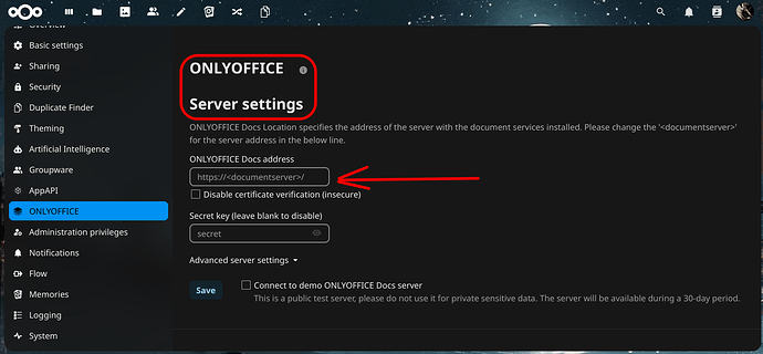

hello @Wolfgang
This quote has got my atention… the OnlyOffice app that exist into Nextcloud repository will allow you only to create a link between Nextcloud and OnlyOffice server…
if you look into the app settings, you may noticed it… here a screenshot:
Do you have OnlyOffice Server installed?
Yes, please make sure Document Server is installed and accessible from the machine with Nextcloud (you can try wget from both machines and check), also make sure that https is enabled on both sides. Send us the screenshot of your Nextcloud settings from the page suggested by @Yassine as well as the version of Onlyoffice Docs installed, Document Server logs (/var/log/onlyoffice/documentserver)
