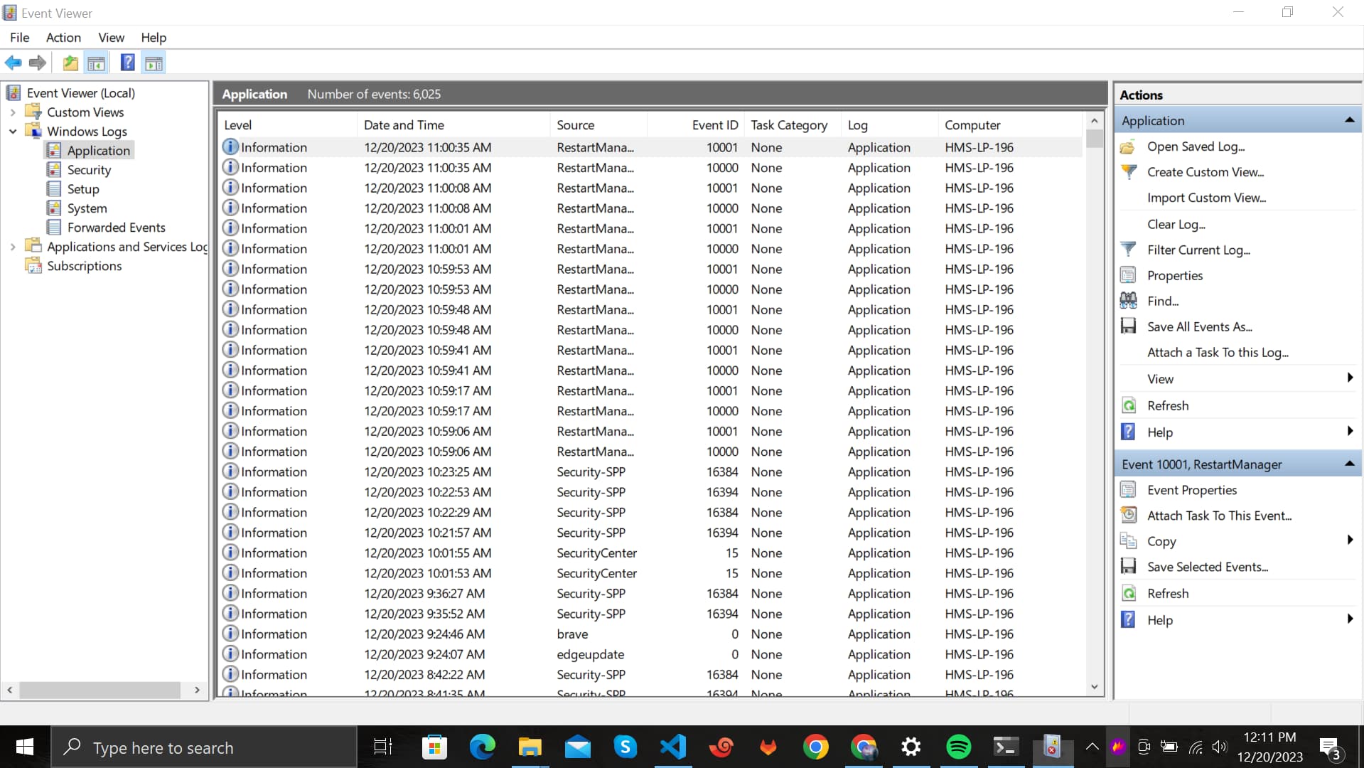

Are there any errors in the event viewer?
Hi, here are the logs for the BuildandDeploy.bat and ManageServices.bat files.
The event viewer also came with no warnings or errors.
