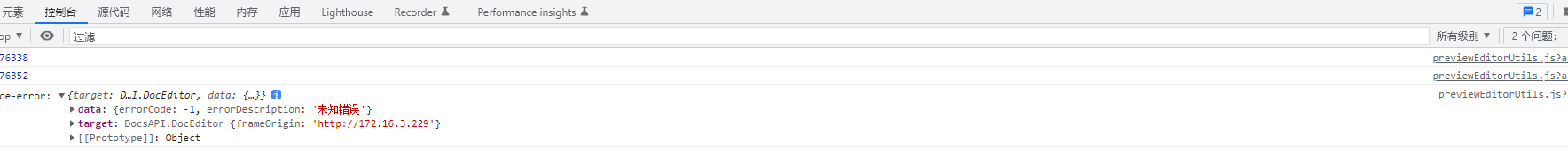

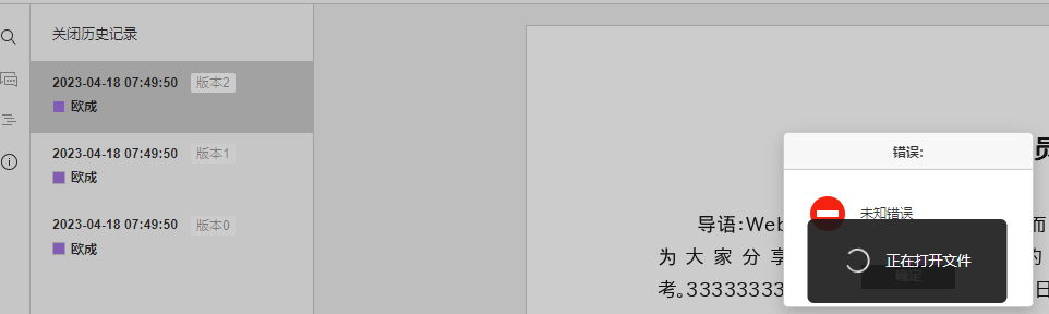

Click one item of history data,show a unknow error
Do you want to: history open fail :thinking:
try to open my history file,
when i click history one item button,the documentserver response msg:unknow error.
windows msg:

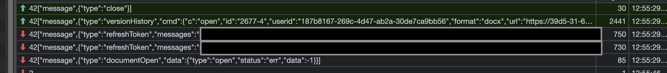

ws msg :

ok,the broswer console img:

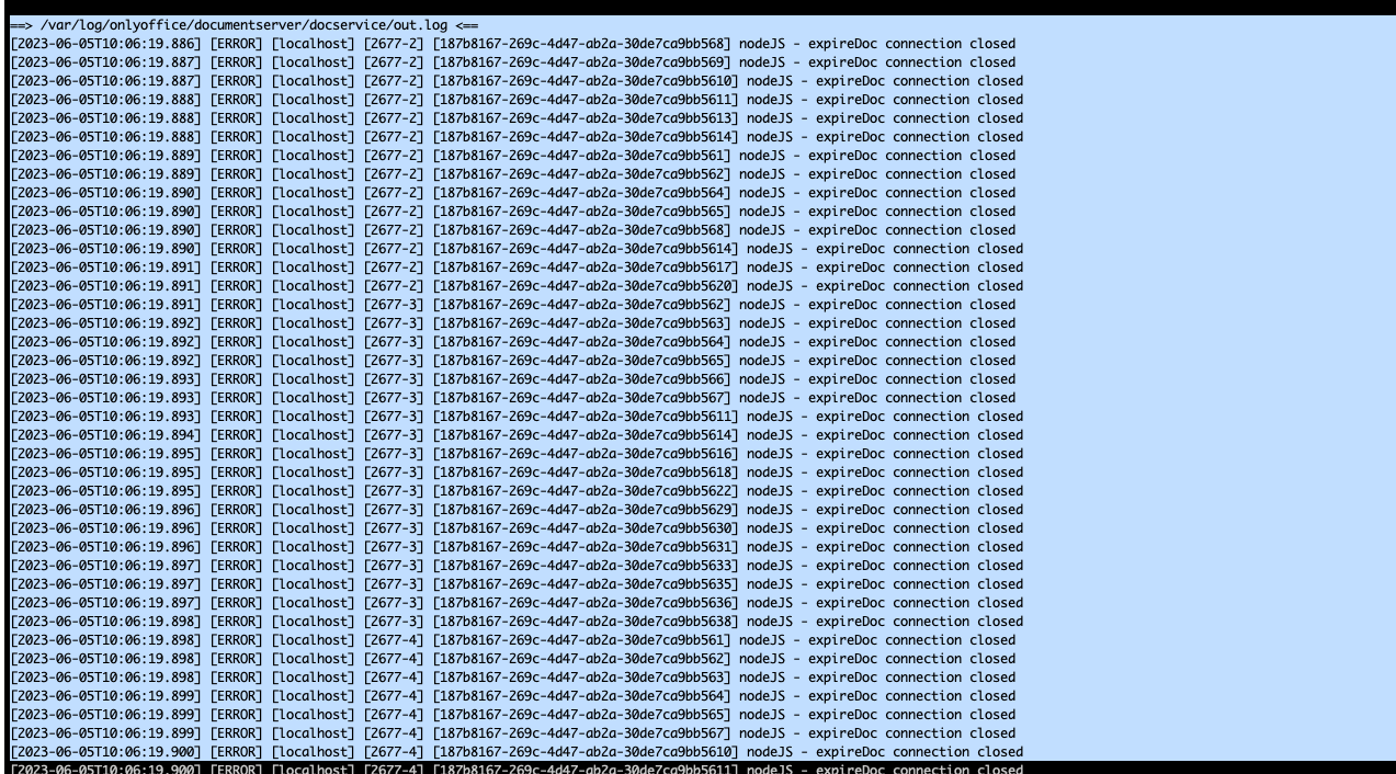

doucument server log for nginx:
doucument server log for converter:
doucument server log for dsservice:
doucument server log for metrics:
i show all the files between converter file log and metrics,all the err.log file is nothing.

If you don’t mind I will join this thread too. Please clarify the file format of your file (doc\docx) from your test. Additionally, was there any error lines in the Network tab of browser console?

  2. on video. Nothing in console
