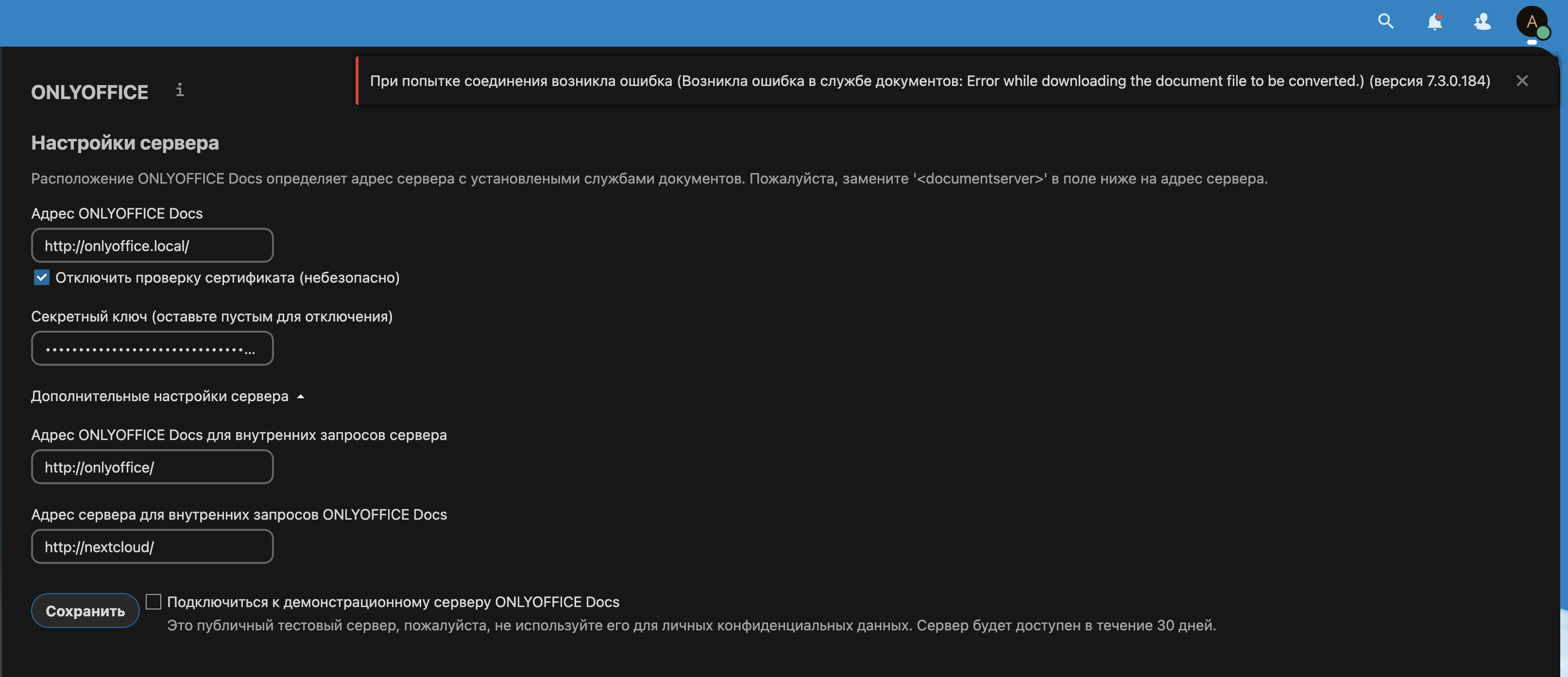

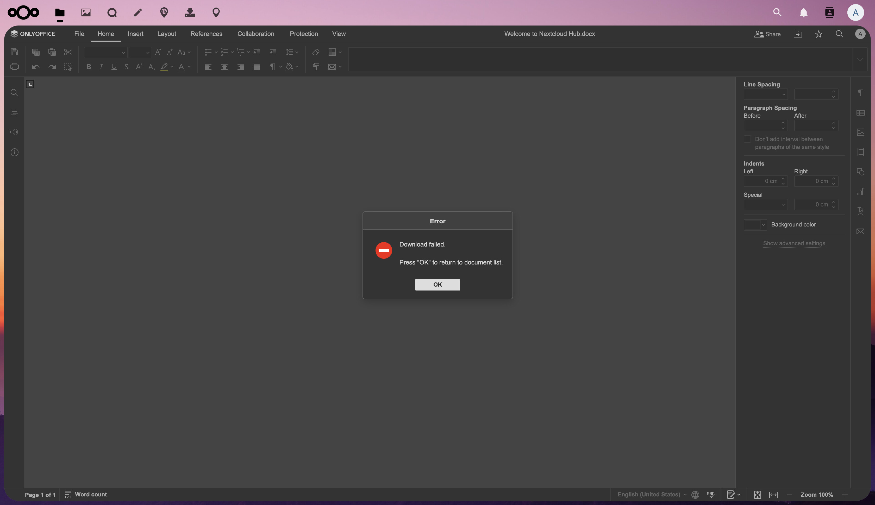

Can't use onlyoffice after migrating NC to new server (error nodeJS - error downloadFile)
Hello @deimjons
Sorry for the delayed response.
I have noted one interesting moment: on one of your screenshots the version of Document Server is 7.3.0.184, but from the most recent logs that you’ve shared I can see the version 7.2.2.56.

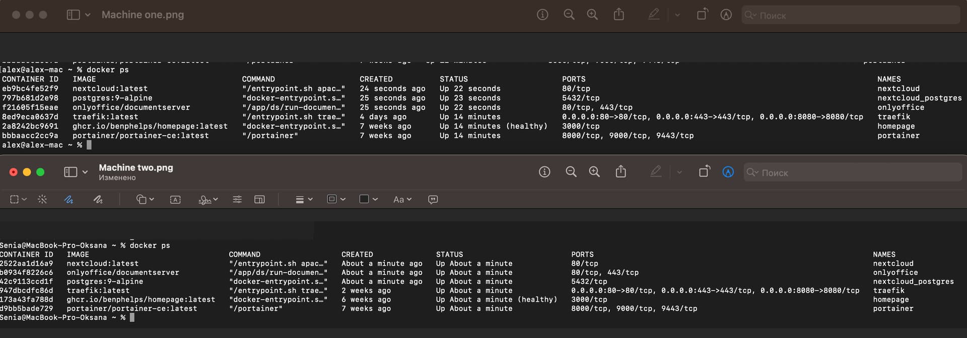

Could you please share the output of docker ps without filters with us?
I am so sorry about this mistake. I run the same docker compose project on 2 different machines ( 2 Macbooks with different OS versions, but with the same version of docker desktop - 4.16.2 (95914). On the one of the machines, Only Office container was not updated.
I attached docker ps from both machines.

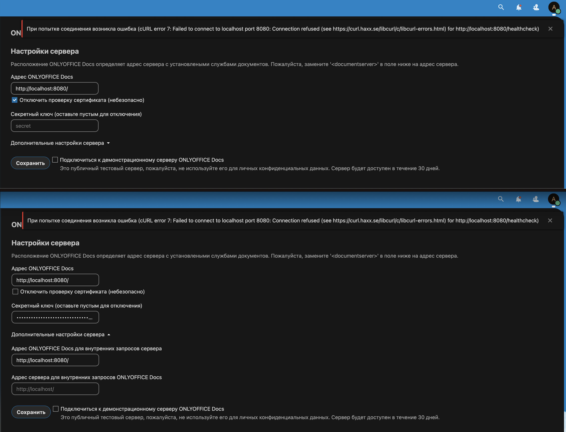

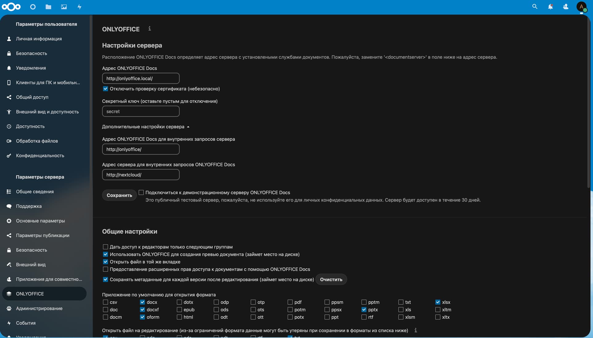

Screenshots what I posted on 11 February releated to the computer 1. Nextcloud Hub 3 (25.0.3), Only Office 7.3.0.184.
Screenshots posted on 23-25 February are from machine 2. Nextcloud Hub 3 (25.0.2), Only Office 7.2.2.56.
Below attaching docker ps results from both MacBooks:

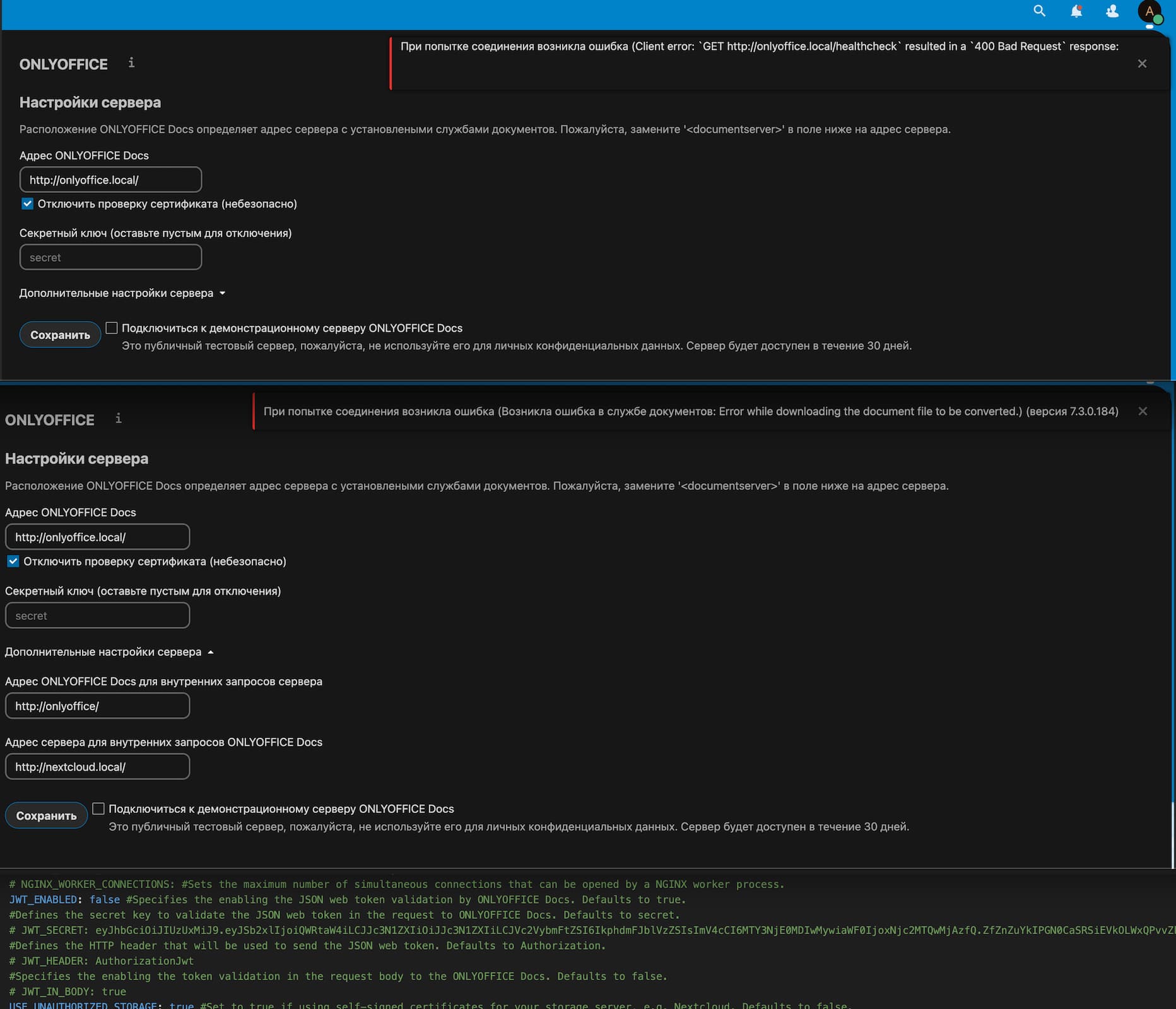

Test session 1:
Test session 2:

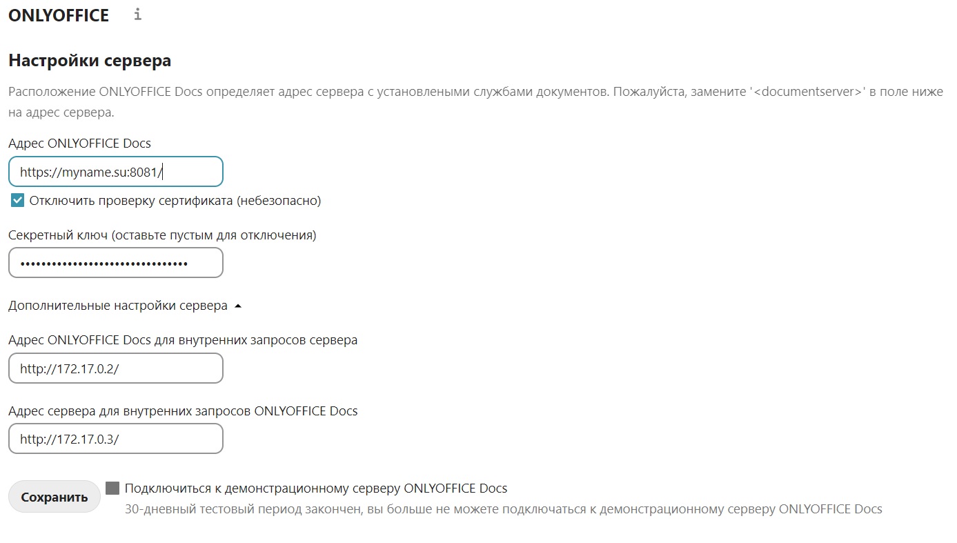

  • JWT enabled, the extra server setting for the nextcloud (Дополнительные настройки сервера) is disabled.
  • JWT enabled, used extra settings for the nextcloud.

P.S. Around 1 year ago I tried to set up the same containers on proxmox and had similar errors. DevOps in our company had solved the problem but I did not saw his solution. Also, I haven’t his contacts to ask how he did it previously. Based on it I think that the problem is not related to the environment. After today’s test, I start thinking that the problem is related to the webserver configuration in nextcloud/onlyoffice and to CORS protection.
Please try setting address for the internal requests to Nextcloud from Document Server in the advanced settings of the connector as http://nextcloud/ without local and see if it makes any difference. So the complete configuration looks like this:
ONLYOFFICE Docs address - http://onlyoffice.local/;
Secret key - your secret;
ONLYOFFICE Docs address for internal requests from the server - http://onlyoffice/;
Server address for internal requests from ONLYOFFICE Docs http://nextcloud/.
Also, just to make sure that the servers are accessible to each other try using wget command too:
From Document Server container wget http:/nextcloud.local/ and wget http://nextcloud/ and from Nextcloud container wget http://onlyoffice.local/ and wget http://onlyoffice/. Share the outputs afterwards please.
Another side note: check out the example of Traefik configuration for Document Server and compare it to the one that you have:
https://github.com/ONLYOFFICE/document-server-proxy/blob/master/traefik/minimal.toml
I set up the onlyoffice as you wrote. It gave same mistake “Error while downloading the document file to be converted.) (version 7.3.0.184)”

root@8db90780eb89:/var/www/html# wget http://onlyoffice.local/
--2023-03-02 10:59:30--  http://onlyoffice.local/
Resolving onlyoffice.local (onlyoffice.local)... 127.0.0.1
Connecting to onlyoffice.local (onlyoffice.local)|127.0.0.1|:80... connected.
HTTP request sent, awaiting response... 400 Bad Request
2023-03-02 10:59:45 ERROR 400: Bad Request.

I disabled traefik. And ran Nextcloud and Document Server containers on different ports.
Nextcloud has port 80 and onlyoffice - 8080.
I set up the onlyoffice and got mistake “(cURL error 7: Failed to connect to localhost port 8080: Connection refused (see https: //curl.haxx.se/libcurl/c/libcurl-errors.html) for http ://localhost:8080/healthcheck)”. But from web-browser by address of onlyoffice http ://localhost:8080/healthcheck I receive true.
I got this error when JWT was disabled and enabled. I attached screenshot.
Also when I tried to connect to demo server ONLYOFFICE Docs I got error “Error while downloading the document file to be converted.) (версия 7.3.2.8)”.
I am getting the same errors. NC AIO and OnlyOffice are installed as docker containers on the same machine (Linux).
OnlyOffice is installed on port 8081, because Port 80 is occupied by NC AIO.
OnlyOffice can be opened in a browser using a domain name on port 8081 without any problems (of course, without ssl).
For communication between OnlyOffice and NC AIO, both containers are added to the docker network bridge, and these local addresses in the docker network are specified in the Nextcloud settings for the Onlyoffice server.
The result is an error: “Error while downloading the document file to be converted”.

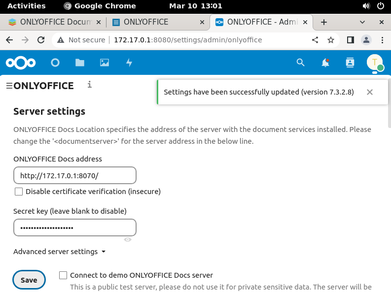

Hello @deimjons
Sorry for the late reply.
First of all, you have to keep in mind that localhost address from your machine is different to the localhost inside the container. Keeping that in mind, you have to avoid using localhost:port address for either Document Server or Nextcloud.
To successfully access Document Server you have to use IP address of the host machine and also specify the port. For example, I was running tests on Ubuntu 22.04 LTS virtual machine and its IP address was 172.17.0.1, port of the Docker container with Document Server was 8070, so in browser I was able to run editors via built-in test example on 172.17.0.1:8070/example/ (remember that you have to enable it first before accessing).
So, the same thing should be performed with Nextcloud. However, “out of the box” you won’t be able to access it via 172.17.0.1:8080 (8080 was default port for regular Docker installation, not Docker Compose). You will face Access through untrusted domain warning upon attempting to do it. To add this address to trusted you have to edit config.php of Nextcloud that is located in /config/ catalog of root folder of Nextcloud installation. Simply add 172.17.0.1:8080 to the 'trusted_domains' section like that:
  'trusted_domains' =>
  array (
    0 => 'localhost:8080',
    1 => '172.17.0.1:8080',
After that you can access your Nextcloud via 172.17.0.1:8080 and proceed to the Document Server configuration. Open connector app settings and use before mentioned 172.17.0.1:8070 address of Document Server and fill Secret field if JWT Token is enabled.
With all these configurations I was able to connect (note that I’m not using Advanced settings):
Keep in mind that address 172.17.0.1 here is for the reference only, as well as ports - this is what I was working with. In your case you have to use proper values of your machine/installation.
Side note: the ideal scenario of Document Server usage, in general, is that both Document Server and storage are located on separate dedicated servers and are available via domain names for communication.
I hope this information will be useful for you.

Hello guys.
I had the same problem and did everything as described here; however, I got another error.
When I try to open a doc file Welcome to Nextcloud Hub.docx, I get an error: Download failed.
I checked it with JWT enabled. On Onlyoffice config page I get Settings has been successfully updated (version 7.3.3.49).
From the web browser by address https://office.mydomain.com/healthcheck/, I received true.
If JWT is disabled, when I try to open the Word file, it shows the same error Download failed.
