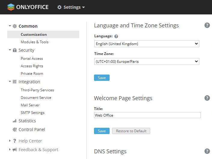

I have read the guide that you have indicated to me, but in my installation of Onlyoffice Workspace I do not find anywhere the screen from where I can disable and or remove a portal.
In the guide there is a Screnshot that is different from mine that I am attaching below.

Please run a test. Go to Community server container and run service monoserve restart. Will Data Management option appear in portal settings after this action?

I have carried out the procedure you indicated, but I cannot find the items: Data Management and Portal Deactivation/Deletion anywhere.
Any other suggestions?
