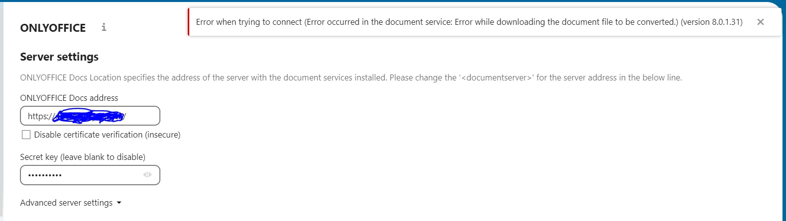

I am having trouble trying to to connect the onlyoffice app to nextcloud. I am running on the latest version of Unraid OS 6.12.08. I have nextcloud installed via docker. I have the OnlyOfficeDocumentServer app installed via docker. I can access my server and nextcloud via cloudflare tunnels which I also have setup on the same server.
I created a cloudflare tunnel instance for the document server and it works and I can access the server address remotely. I have the secret inputted as well but when I input the same cloudflare address into the Server settings in Nextcloud for Onlyoffice I am getting an error of “Error when trying to connect (Error occurred in the document service: Error while downloading the document file to be converted.) (version 8.0.1.31)”.

Hello @Ja55ie
Document Server does not validate self-signed certificates by default. To overwrite this behavior you need to set rejectUnauthorized to false in default.json config.
In Docker container with Document Server please locate this config in /etc/onlyoffice/documentserver/, change the value, save the change and restart Document Server services with command supervisorctl restart all. After that please try connecting again.
Thank you! This fixed my issue. I went into Unraid Terminal, then hit docker ps command, then docker exec -it [ID] bash command then cd /etc/onlyoffice/documentserver/
command then selected nano default.json then changed the rejectUnauthorized value to false.
