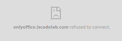

But when trying to edit a document from NextCloud I get this error.
I have read multiple posts about similar issues but can’t figure out what is wrong in my case.
Any help would be much appreciated.

That image appears when you edit or when you try to make the connection in the plugin, where do you put the documentserver IP and the secret key?
Do you have anything additional configured in the addon?
The image appears when I click on any document associated with onlyoffice docx, pptx, etc.
I set the document server IP (a DNS really in my case) in nextcloud onlyoffice plugin setup page.
When I set the connection parameters in the plugin setup page I don’t get any errors, and a second part of added configuration parameters become available.
I have tried also to disable certificate validation (although is not something I would like leave in case it works) but that does not solve the issue either.

Hi @infinityysteel .
I think I forgot to mention that I am using Cloudflare as application firewall.
After your comments I thought maybe that was the issue…
And I noticed the following
Everything works fine when Cloudflare application firewall is not enabled.
So for now at least It works !! :smiley: and I can use it but I am missing cloudflare protections.
However I would prefer to keep using cloudflare protections.
Do you (or someone) know how can I make it work even if I have cloudflare proxied enabled?
Is there a configuration file where I can put maybe trusted proxies?
Is that probably what is missing?
Thanks again.
That’s why I told you about the firewall, the image is similar to when we do not have full access to the internet (certain ports) since it did not show you the 504 error, now we know that the detail is in the firewall, which is why I told you that you did have rules . It is best to check what rules you have in Cloudflare.
