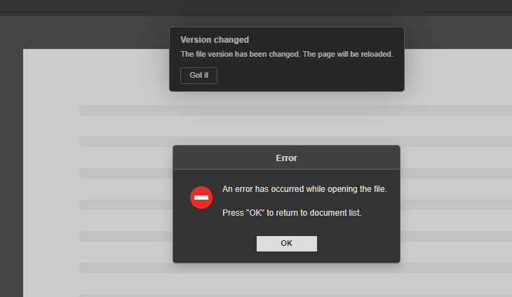

Hi everyone! I just installed OnlyOffice document server via docker to use with my Nextcloud setup. Installation went well, I can access the welcome page of OnlyOffice and started the test example server to see what it looks like. However, when I open a document, I am first faced with a long document loading and then with the error message “The file cannot be accessed right now”.

==> /var/log/onlyoffice/documentserver/docservice/out.log <==
[2025-05-16T09:19:27.696] [ERROR] [localhost] [docId] [userId] nodeJS - [AMQP] Error: read ECONNRESET
    at TCP.onStreamRead (node:internal/stream_base_commons:217:20)
==> /var/log/onlyoffice/documentserver/converter/out.log <==
[2025-05-16T09:19:29.613] [ERROR] [localhost] [docId] [userId] nodeJS - [AMQP] Error: read ECONNRESET
[2025-05-16T09:19:31.701] [ERROR] [localhost] [docId] [userId] nodeJS - [AMQP] Error: read ECONNRESET
[2025-05-16T09:19:33.619] [ERROR] [localhost] [docId] [userId] nodeJS - [AMQP] Error: read ECONNRESET
[2025-05-16T09:19:35.707] [ERROR] [localhost] [docId] [userId] nodeJS - [AMQP] Error: read ECONNRESET
From the logs excerpt that you provided it can be seen that the issue is related to Rabbitmq (it would be much more helpful if you provided full logs).
Also, the following information is needed:
  1. Are you using internal or external rabbitmq?
  2. What is the rabbitmq version?
  3. service rabbitmq-server status command’s output
  4. netstat -tulpn | grep 5672 command’s output
  5. rabbitmq logs: /var/log/rabbitmq
  6. local.json (/etc/onlyoffice/documentserver/local.json)
