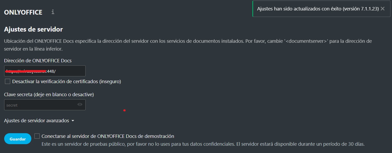

Hello.
I’m not an expert in Debian, but some time ago I set up a server on a laptop that I had cornered, and finally I installed a Nextcloud for my family, and we saved photos, etc.
We are 7 users, and we all connect from external sites.
Each one from home, office, with the mobile, etc.
It’s been a week since I installed Onlyoffice on my private Nextcloud and I can’t get it to work.
Both Nextcloud and Onlyoffice are installed directly on the server, WITHOUT Docker.
The office tools appear in nextcloud, but the documents do not open.
The message is Cannot access ONLYOFFICE. Please contact admin
The configuration in the integration says that it is correct
The connection between Nextcloud and Onlyoffice is correct
nginx listens for http ports at 88, and https at 448, and is working without problems
Please, if someone with more experience can help me, I would be very grateful.
Thank you very much.
I can not put images or screenshots because I’m new to the forum.

  5. Please go to connector app page > click Save button and make a screenshot of the result.

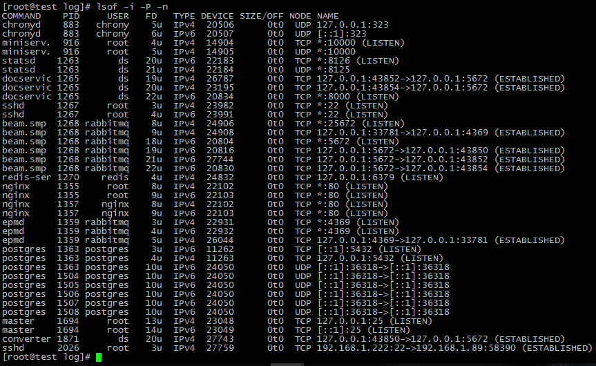

Good afternoon. I also encountered the problem “Please contact the administrator” When configuring the ownCloud connector (192.168.1.9) I specify the server address with ONLYOFFICE Docs Community Edition (192.168.1.222) all server parameters are visible. I can choose document types and everything else. ownCloud has a + button for creating all types of documents. But here’s the trouble when creating (or de-editing a previously uploaded document) it pops up “The ONLYOFFICE application is not available. Please contact the administrator.” If you press F 12 on Google Chrome, then in the network tab you can see the error "Access to script at ‘http://192.168.1.222:8000/web-apps/apps/api/documents/api.js’ from origin ‘http:/ /cloud.anhorsayli.uz’ has been blocked by CORS policy: The request client is not a secure context and the resource is in more-private address space private.
There are no errors in the logs on the ONLYOFFICE Docs Community Edition server side.
/var/log/onlyoffice/documentserver/converter/epr.log
/var/log/onlyoffice/documentserver/docservice/epr.log
/var/log/onlyoffice/documentserver/metrics/ep.log
they are all empty.
All necessary ports seem to work and listen.
Still trying to find where the error is. I already think that it is not on the side of ONLYOFFICE Docs Community Edition. All the same, probably an error somewhere on the server side with ownCloud 10.11.0 (stable)
Hello @MrTank
According to the error entry which you faced, it looks like your browser blocks the request from from a less private network resource.
If you’re using Chrome, it is probably caused by the following policy: Private Network Access update: Introducing a deprecation trial - Chrome Developers. The article describes multiple ways of solving the issue, including switching both resources to HTTPS.
