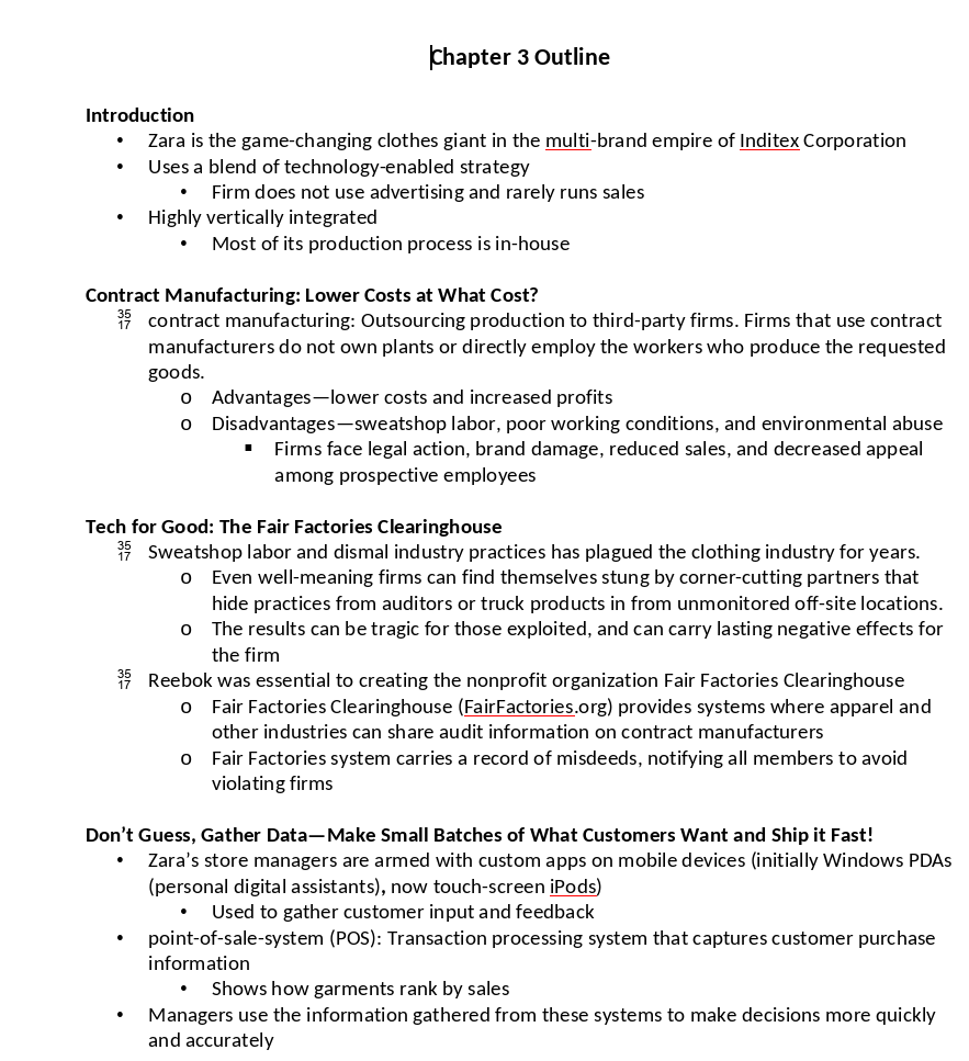

I have to download Word documents from my teacher at the University. When I open them in ONLYOFFICE in Fedora 36, the bullet points appear as numbers 35,17. See image for comparison.

Here you go:
Thank you for provided file. I have checked it on my Fedora 36 (with the latest Desktop Editors), but everything seems OK. Could you please try to re-install Desktop Editors and re-check the issue?

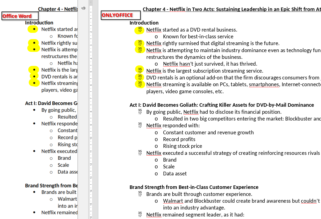

One thing I did notice is that I opened a different Word document and discovered this:
You’ll notice that some bullets appear normal in the first and last section while toward the middle section they appear as 3517. Still more oddity.
