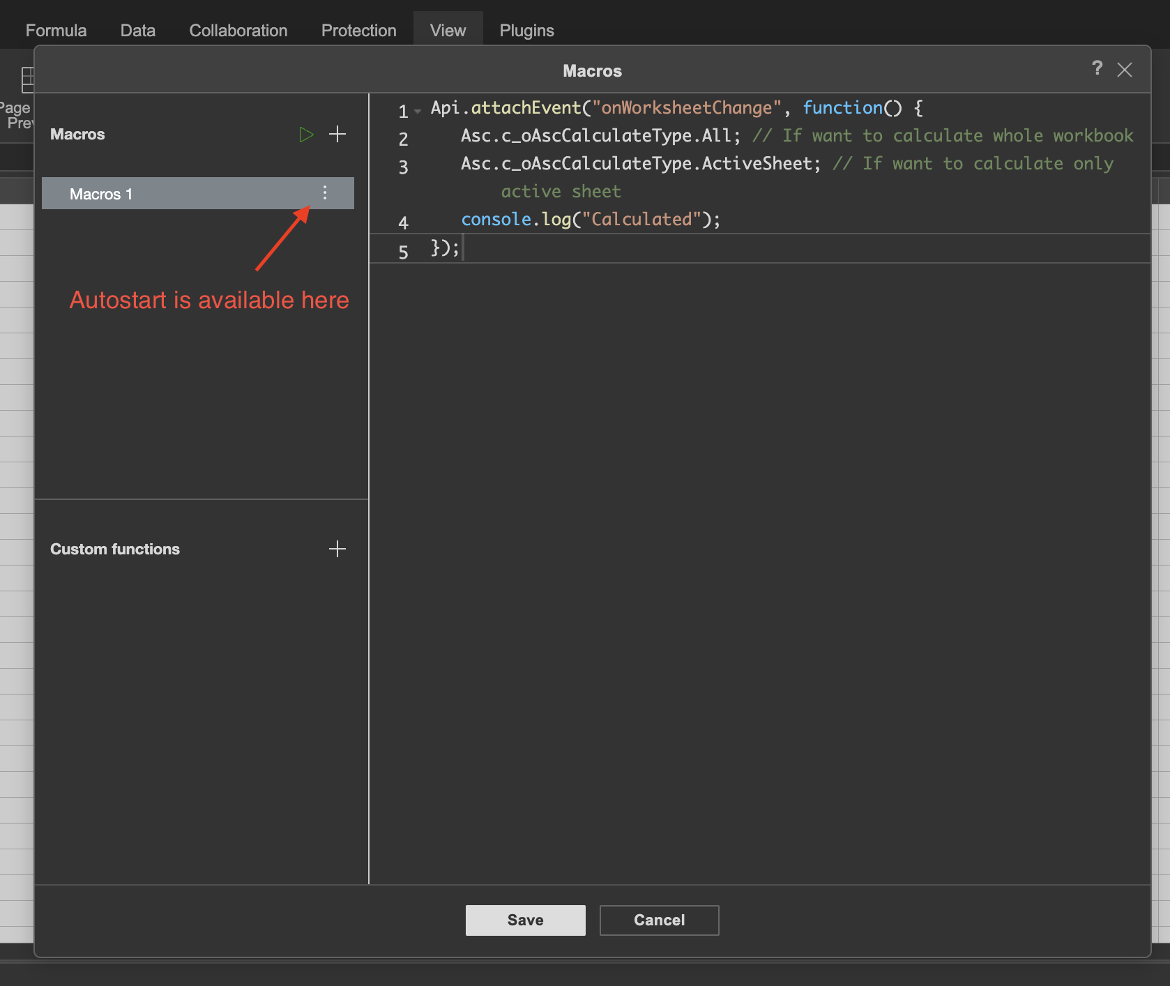

Macros is generally a system plugin that allows running various Office API methods in the editor. It is available in View tab on the main toolbar or in Plugins tab for versions of Document Server lower then 8.2.
When opening this plugin, you will see a window where you can insert your code. In case of mentioned macro, you should insert whole sample.
Here is a screenshot for the reference:

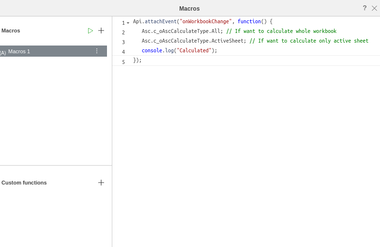

Still struggling a little bit.
I managed by making it work in one workbook. I had the change the macro from “onWorksheetChange” to “onWorkbookChange” because the array formula relates to the whole workbook.
Now the problem is, in one workbook it’s fully functional. But on another one where I try to apply the same, nothing happens. Any suggestions? Here’s the screenshot.
