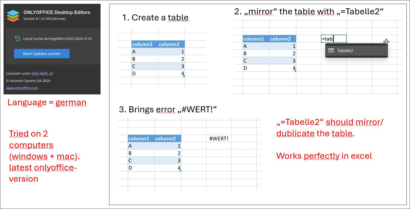

Bug report: =table doesn't work
Dear all,
I want to report the following bug. See the steps (1. 2. and 3.)
Tested on windows 11 and mac OS13.
So here is a picture that describes the bug:

Do I understand correctly that between steps 1 and 2 you are also defying a name for selected cells array, i.e. by selecting array of cell, right-clicking it and using Define name option?
thanks for the response. No, I didn’t defy a name.
All I did is seen in the pic. Works perfectly in excel.
All I want is to “mirror” a table. Works with “=tablename” in excel, but not in onlyoffce.
Thanks

Thank you for the file. Indeed, it is named range added with File tab > Format as table template and it can be found in Name manager.
We are aware of this issue, so I am adding your query to it. Your interest is much appreciated.
