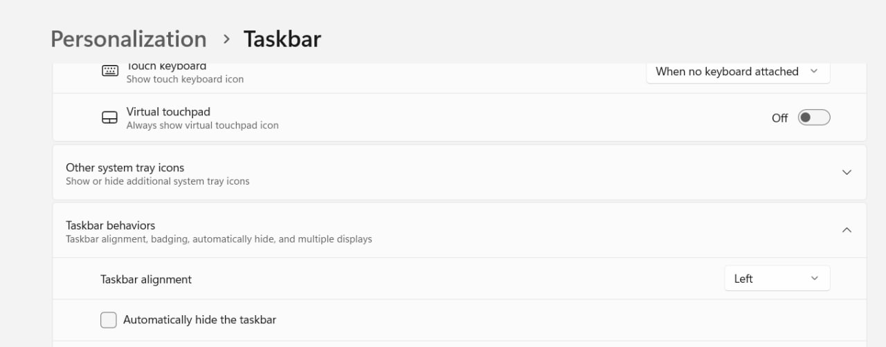

  2. Are you using Taskbar behaviors > Automatically hide taskbar. (in taskbar settings)?
Hi Nikolas
  1. When I recorded the video, no external screen or monitors were plugged.
    However, I often plug / unplug external screen or projector (at home: laptop closed/external screen plugged, at work: projector plugged or unplugged).
  2. No, I don’t automatically hide the taskbar (otherwise, you should see it in the video).

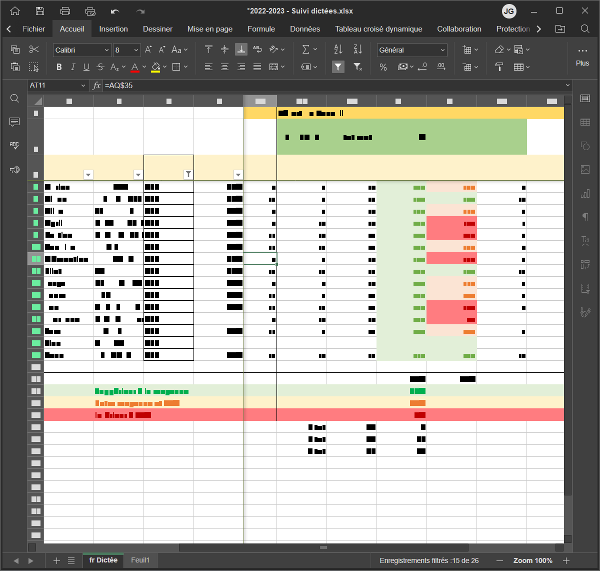

However, I’ve seen an other “display” issue in presentation:
This is easy to solve : just change the zoom level.

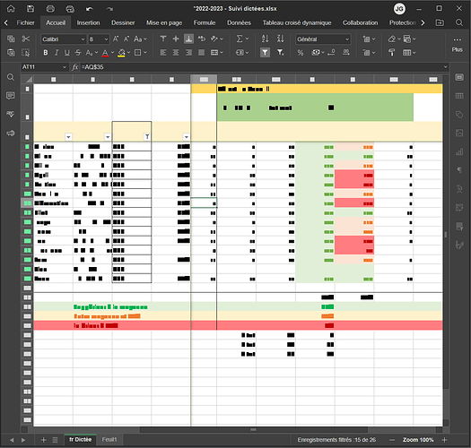

In Presentation, I have also seen another issue:
Here, no other solution than to close the file & reopen it.
I don’t know if the former issue is linked to the 2 new ones.

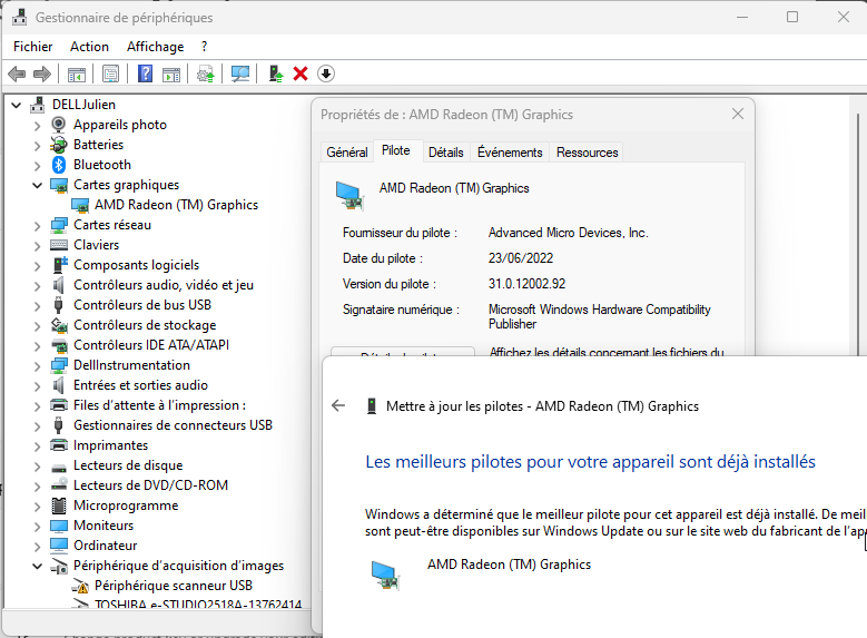

Can I ask you for the following information:
  • The exact OS version;
  • GPU and driver version.
Like this:
(the driver is the most up-to-date according to windows)

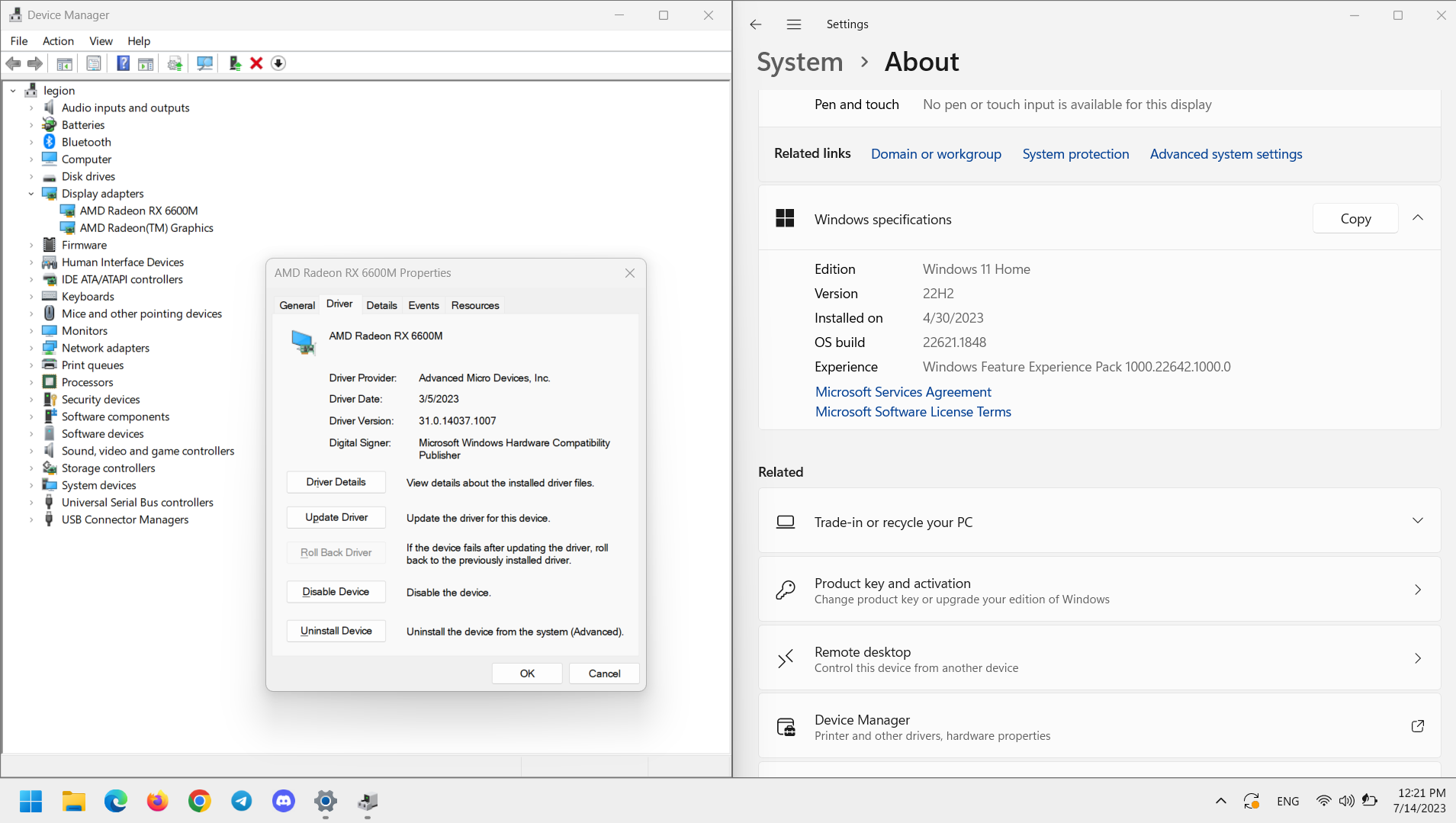

We have noticed that you are using multiple monitors.
The information we need from you:
  1. The exact model of your laptop (to identify the processor).
  2. The display settings for both your laptop and external monitors.
  3. The scaling settings for the monitors in your system.
We also recommend updating the drivers on your system. Please check/download them from the AMD website.
