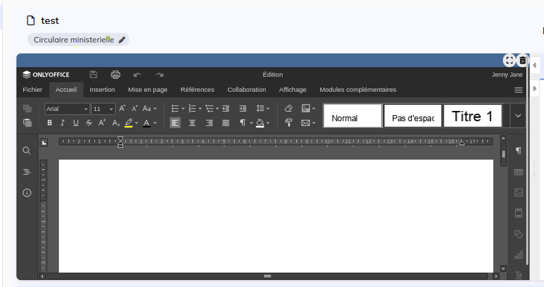

I’m having a problem with onlyoffice solution installed as an official image. the solution is deployed withing an infrastructure with an apache server that push all requests from api to the onlyoffice and visa versa.
I can upload a file (ODT), I have no issues, the POST request is OK all the headers are correctly set and authentication, I get 200 with {“type”:“save”,“status”:“ok”,“data”:“oEUe8_3459”}
Once the page is reloaded trying the GET the file request, the file is then empty, without any errors on neither the logs or on browser console, except the websocket
GET
wss://private_url/7.1.1-23/doc/Qx5tu/c/182/z0nxzb4w/websocket 400 bad request
Firefox can’t estalish connextion to the server at the address wss://private_url/7.1.1-23/doc/Qx5tu/c/182/z0nxzb4w/websocket.
The file empty, and I explored many solution but I stil can’t resolve this one. Can you please help ?
Attached some screenshots
