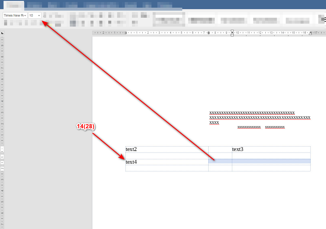

In out_file “text4” in a table created at the end of file should has fontsize 10(20), but it has 14(28)., other cells in this row (2) has 10(20), but only cells. Text4 doesn’t get TextPr with fontsize 10(20), I don’t know why.

Checked.
Text4 left with 28 fontsize.
Code doesn’t work. Maybe, error in a code? Can’t find it, as I see in examples - code must work properly. In a picture: cells after first cell became 10(20) fontsize (it’s right), but first cell with text4 still 14(28) - but it should get 10(20) because TextPr applies to the entire row.
