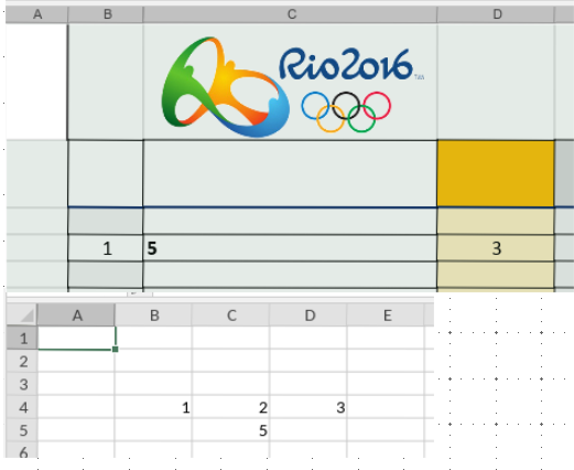

Hi,
Thanks for your answer. My goal is to remove several rows.
I have a spreadsheet where I want for example to remove rows 2 and 3.
I think that oRange.Delete(“up”); is the right command.
I tryed it on your demo and the 5 initially placed in C4 once the delete(“up”) is done.
On our version from onlyoffice the 5 does not move.
screenshot_macro_demo

Hi,
The Delete method is definitly not working on our onlyoffice version and it works well on your demo page.
Thanks for the code I will definitly use it as soon as our administrator will have fixed the issue.
