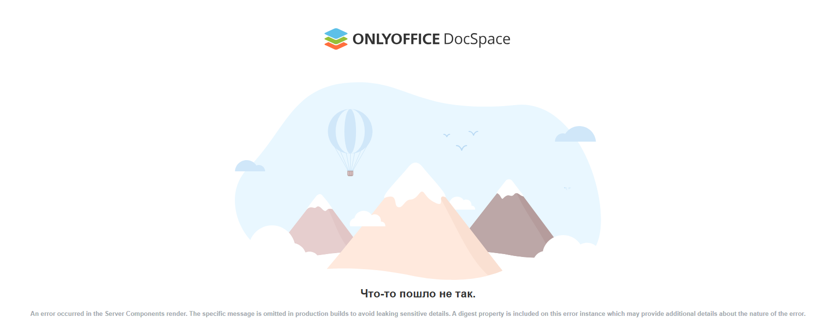

I installed docspace community on a local server with IP address 192.168.31.113/24. The server works great, invitation letters are sent, etc. Within the local network, any device has access to the docspace server. there was a need to gain access outside the local network. Since there is a white static IP address, ports to the docspace server were forwarded on the router side. however, when trying to log into the server using a static external address, an error appears
Error: An error occurred in the Server Components render. The specific message is omitted in production builds to avoid leaking sensitive details. A digest property is included on this error instance which may provide additional details about the nature of the error.

Hello @Snowlakes
Please specify the guide that was used to install DocSpace. The address that you’ve mentioned contains a path after it, can you describe what is it? It is a virtual path or some sort of it?
