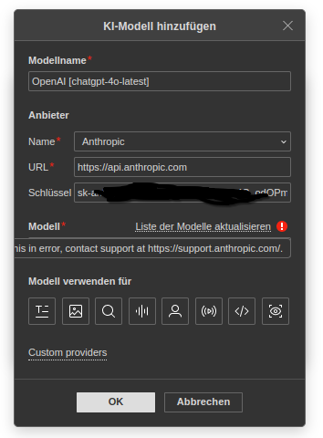

→ It fails with the following (incompletely displayed) error message:
Anthropic
I’ve tested the Antropic API key in other applications (e.g. VS-Code extension). It works. I’ve checked my internet connection, too.

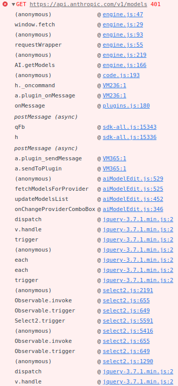

Thanks for your quick response! The finger point to the debug mode was perfect. I think I was able to nail it down to a CORS problem:
Console:
Network:
Request URL: https://api.anthropic.com/v1/models

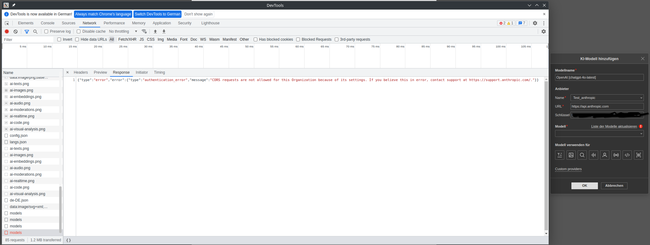

→ Response:
{"type":"error","error":{"type":"authentication_error","message":"CORS requests are not allowed for this Organization because of its settings. If you believe this in error, contact support at https://support.anthropic.com/."}}
Does this help you to analyze the problem further?

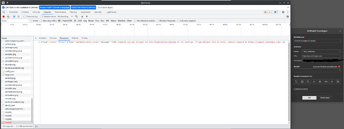

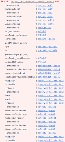

Yes it looks the same. I attempted to add Anthropic as an AI model. After selecting “update Models list” fails to update the models I grabbed these screens
Network:

Repsonse:
{“type”:“error”,“error”:{“type”:“authentication_error”,“message”:"CORS requests are not allowed for this Organization because of its settings. If you believe this in error…
