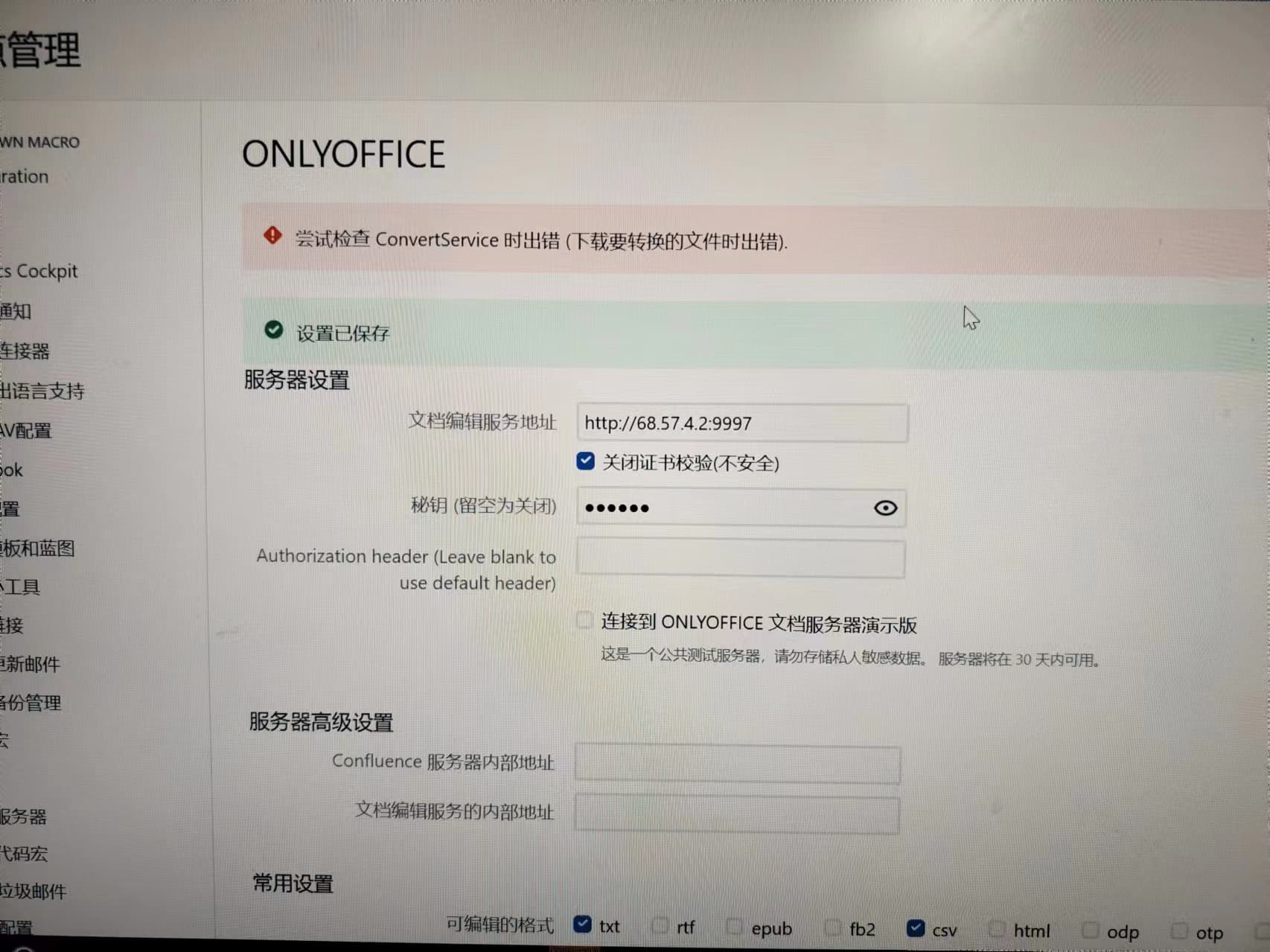

I get a almost same question
my ONLYOFFICE is 8.0, the IP address of the machine with ONLYOFFICE Docs installed in
http://68.57.4.2:9997, the project running, it seems OK.
but when I connect with Confluence ,( my confluence is 8.5.2 ,webside is :http://68.57.4.2:9977 ,
the Plugin is 5.0), I get a Error.
I have already change local.json and I Fill in the Plugin Page as require:
By the way ,my linux server is offline.
Hello @wangpf :wave:
Could you please create a separate topic for discussing this issue? Additionally, I need some more information:
  1. I want to inform you that the current version of the document server is 8.1.:slight_smile:
  2. Type of installation of Document Server (exe, docker, deb/rpm).
  3. How is your network set up?
  4. Please provide a link to an archive containing the following files:
  • local.json
  • default.json
  • logs from the /var/log/onlyoffice/documentserver/ directory
  1. Is the trial period activation for ONLYOFFICE working?
Thank you.
